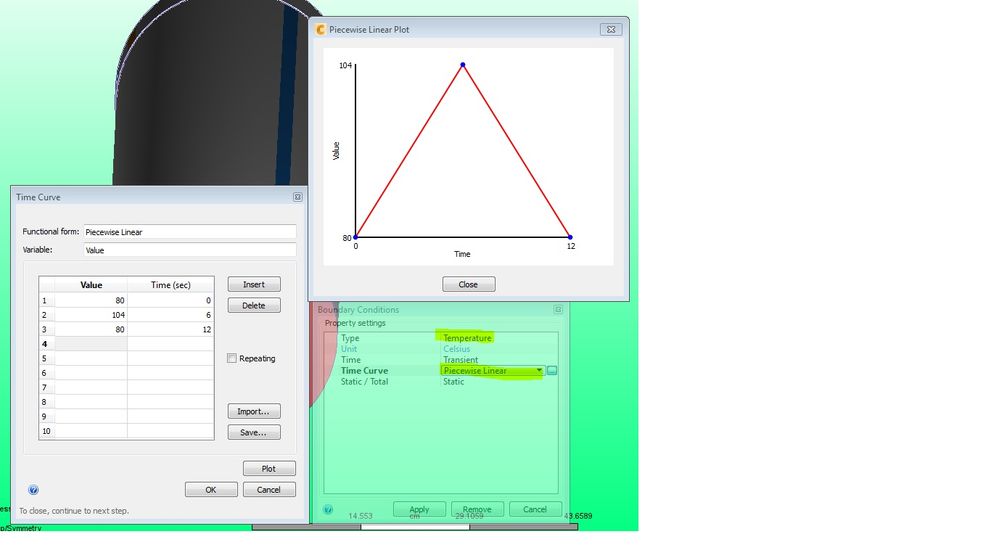

Hello everyone,
I am trying to set a transient temperature boundary condition. I have never done transient analysis before.
Is there anyway I can set an ambient temperature to be 80 F at 6 am, 104 F at 12 pm, and back to 80 F at 6 pm?
Thank you.

Thank you.
Just a small detail...
If you want from 6am to 12 pm, you need to convert it to seconds (6*60*60=21600s) , because the time unit is second.
Thank you.
Yes I did that.
