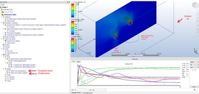

Here is a .cfz file and some further explanation of the case. I have some questions in order to help me validate the simulation. (i tried to drag and browse the file but i get a message with
"Correct the highlighted errors and try again.
  • The attachment's exhaustandmethane.cfz content type (application/octet-stream) does not match its file extension and has been removed.") How can i share the .cfz file?
Case: A hydrocarbon storage tank with a pressure vacuum safety valve (PVSV) is close to a heater´s exhaust gas at 650°C. Analyze the danger of explosion if the hydrocarbon vapors meet the high temperature exhaust.
Approach: Since Autodesk CFD is not able to mix 3 fluids, I imagine 2 runs of simulation scenarios to analyze this danger.
Scenario #1: How close and at what temperature will the hot exhaust get to the PVSV with certain ambient air velocity.
Scenario #2: How close and at what concentration will the hydrocarbon vapor get to the heater´s exhaust with certain ambient air velocity.
As shared in the file i imagine it has been done correctly. That being stated i do have some doubts/questions.
Q#1: Should I use a created material for fluid scalar mixture of Air-CO2 or Methane?. I suppose yes because I want to input CO2 and hydrocarbons with air.
Q#2: Should I use compressible or incompressible flow on Solve window? I suppose incompressible because it is at ambient location (no enclosed vessel or area).
Q#3: Should I use transient or static? I suppose static is enough since I am worried about the worst-case scenario.
Q#4: Do I need to check gravity box and its direction? I suppose yes since i am interested in heat transfer.
Q#5: Is the fluid mixture correctly applied? I suppose yes following examples on “Scalar Mixing Analyses (Part 1&2)” dated 4 nov 2016 on YouTube Channel “Autodesk Simulation”.
Extra Q: When using Transient solve. What is the difference between assigning IC to all volume’s vs not all volumes? I think i have seen some examples without all volumes and also have been recomended to apply ICs to all volumes.
Here are some screenshots
As allways, thank you very much and best regards!

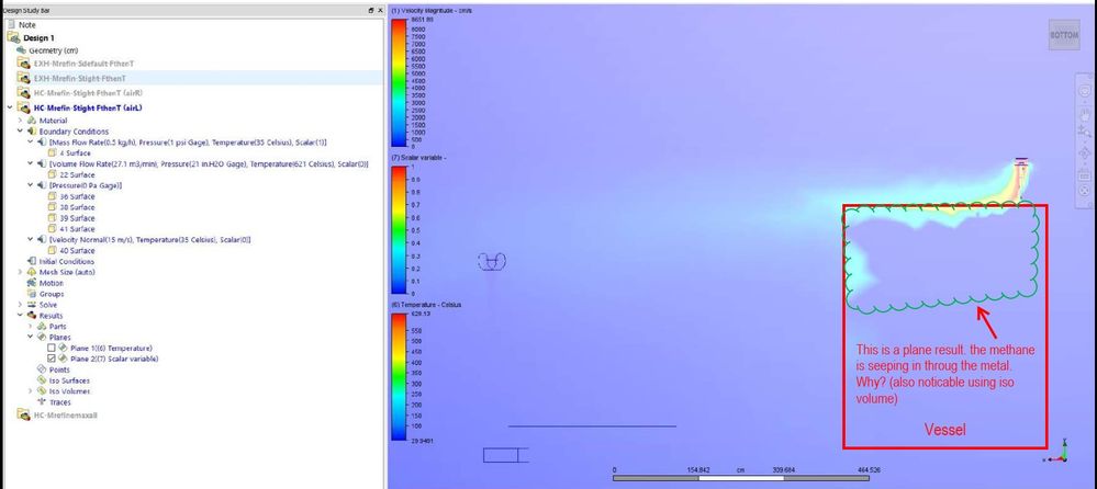

Hello Forum. I share my .cfz file. Case explained above. Welcome are any qustions and coments.
Q1: Does it look allright? (setup and results)
Q2: One big question: Why does scalar colour seep inside the steel tank? (see image)
Materials: created fluid Air-CO2 or Methane (depending on case "EXH" and HC") Density Scalar 0=Air 1=Other fluid. Set on variable. Rest of materials as steel.
BC: shown
Mesh: refined Exhaust outlet (inlet to model) to 0.5 and CFD created volume Air to 0.5.
Solve: Automatic convergment assesment tight. First flow then Heat transfer (gravity applied). General scalar applied acording to case.
image where i question the scalar result
 I also see on Iso volume that the methane is goin inside the vessel through the outlet, as if it were recirculating.
Q3: Is there anything i can do to prevent this aparent seeping and recirculation?
Allways thankfull and best regards.

frederic.gaillard.7
Hello @Anonymous ,
I saw two major flaw in your model,
  1. First and foremost you have internal boundary condition. Those must be removed or be modelized in another way.
    1. What you could do is supress the tank from the mesh and keep your BC as you did.
    2. the other aspect that cause problem is that you have, on the same surface, a pressure and a volume flow rate BC. You can't have them both, i suggest you to keep the 27.1m3/min.
The second major problem is your surface where you apply your P=0 BC. They are too large, recirculation will appears on those surfaces. Withdraw the pressure bc on the lateral face. Keep only the one who is opposed to your intlet (surface40)  You can add slip/symetrie on the side face to neglect the drag.
Hope it helps
Fred

marwan_azzam
Thank you for sending the model.
In addition to what Frederic said:
I ran it here and was not able to get the same plot you show in the image in your post.
To answer why the scalar seeps into the solid, it is just interpolating through one element between a zero and non-zero value.  I would not worry about it.
Having said that.  You have that small inlet where you have both pressure and flow rate defined.  If you know the flow rate delete the pressure.
Also, I don't see why you need any of the Steel parts.  I would suppress them all.  This is a flow analysis and they do not contribute to it.
Marwan
I would also refine the mesh around that small inlet to better capture the flow.
