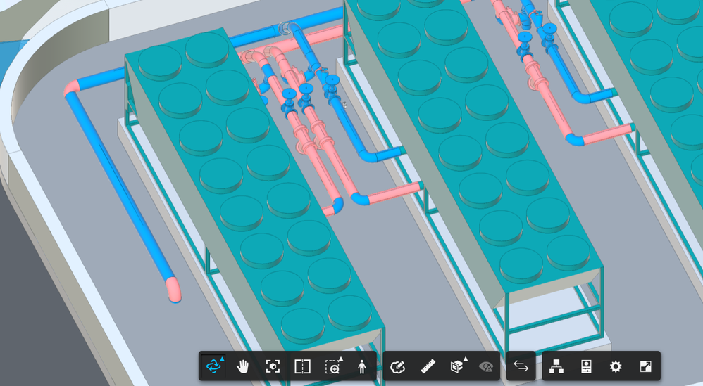

I am some problems when viewing my MEP model in 360 Docs. I have set up a view template to highlight the different systems in different colors using filters. Looks perfect in Revit but when I upload to BIM 360 Docs there are some irregularities (see attached images). Seems to be happening with pipe fittings & accessories. In attached images I am showing CHWS & CHWR, you will see the corner pieces on the Return(pink) are colored blue and on the Supply(blue) they are pink. I am using Revit 2017.Revit ScreenshotRevit Screenshot360 Docs Screenshot360 Docs Screenshot

Thank you for participating in our Community! Would you be able to share this files with me for further investigation? If you can then let me know and will share folder with you.

I was able to duplicate this beahvior with provided Revit Model and reported this to Development team for further investigation. I will give you an update soon.
