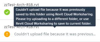

I don't understand why the system gives me the message: "Couldn't upload file because it was previously saved to this folder using Revit Cloud Worksharing. Please try uploading to a different folder, or use Revit Cloud Worksharing to save to current folder."
The original Revit file was created by architect using Revit Cloud Worksharing, and then published.
I found the file with the web based BIM360 Docs system and copied it to my BIM360 folder.
Then I decided to modify the model for my needs. I downloaded it to my C: drive and changed it as required.
Then I wanted to update the "old" file in the BIM360 system with my new version.
Using Autodesk Desktop Connector I could see the BIM360 file with Windows Explorer. So I just drag-and-dropped my new file over the old one. Unfortunately I did see the file was updated in Windows Explorer and in cloud.
So I decided to upload the file with web interface. With Chrome I have found the folder were the file is located and tried to upload my new file there. I expected that the old and new files have the same name and I will get its new version. Instead of that I've got the error message written above.
To have the file updated in cloud I needed to delete the old file and upload the new one.

Once cloud work-sharing (or collaboration, if you want) has been initiated from Revit, you always need to go through Revit to publish. It will not allow you to upload directly on the web and to override the cloud work-shared version.
The workflow you described would break the whole purpose of cloud collaboration, of multiple users working on the same model whilst still keeping track of all changes.
To better explain that, I would like to give you an example. Say you downloaded the model yesterday and started to modify it. At the same time, yesterday, I opened the last synced version from Revit, ran some edits myself and then synced again. Because you haven't visited the model again you are not aware of any changes and because you did not sync I am not aware of any changes you made. So, we're basically both working on our own. At the end of my business day, I synced and published my model that was containing some very important changes. Once again, you are not aware of it and you are still working on your local copy. If you would be allowed to upload today directly through the web interface, the model you would upload would basically override all my important changes synced and published yesterday.
So, it is all for having better control and awareness of what's happening in that central model.

Going back to your initial question to why you directly upload a 'local' version of a file over a cloud work-shared version of the same file, that is because it would break the whole cycle.
Think of all the 'versions' that are not published but just synced as 'in-between' versions saved on an 'intermediary' server. As you know, all versions that are synced by Revit users are visible in Revit even if they are not published. If a Team is working but not publishing, allowing a new version to be uploaded directly to the web would basically ignore all that work that was done, but just not published yet. So, if what you are asking for would be allowed, your team might be working intensively on a model, but not published because they are not ready yet, and you could just upload a version that you initiated from a local copy and that didn't take into account the team's work. So it is all about controlling those changes and the model versioning.
