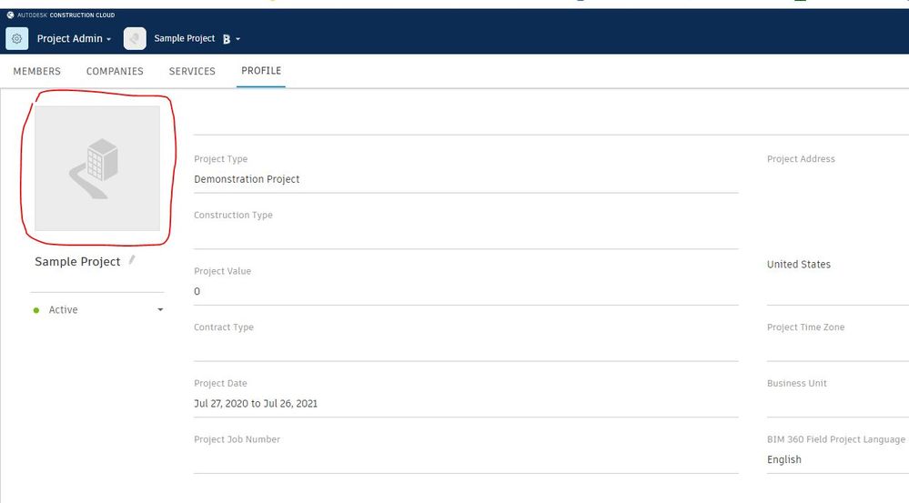

Hello all,
I don't know if somebody noticed that in new BIM360 that is now called Autodesk Construction Cloud you can't change the image (icon) of a project.
So in the actual BIM360 you will go to Project Admin --> Profile --> and from there you have the option to change the icon/image of a project
So were is that change icon button in ACC? Any Ideas, does exist or it will???
Kind regards,
Mircea

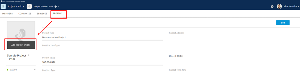

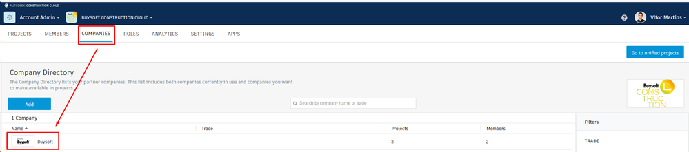

Hello @Mircea_Nicolau
Go to your Account admin and click at the COMPANIES:
Select your Company of the Project:
Go to Projects and select your Project:
Go to Profile and click Add Project Image:
Message 14 of 32
Mircea_Nicolau
Dear Vitor Martins, many many many thanks!!!
Thank you so much for those picture, they really helped me
thank you
Kind regards,
Mircea
