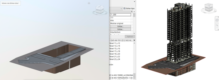

Furthermore, there is no fast way to change nested links hierarchy to flat. You cannot add more than one link without using API (works for Revit 2021+) now. So, whenever you have a model tree in which each object on the site has at least 5 nested links for each discipline/system it becomes a pain.
2021-12-16 16_09_45-Autodesk Revit 2020.2.6 - [NVM-RHI-BE-7600-EFM-3DM-00-00001.rvt - 3D View_ Navis.png
 Please, consider fixing the issue, it would help a lot to improve project coordination.
