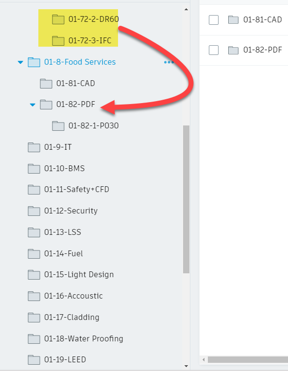

Still very much wanted idea - My project has 25 disciplines and in each of their folder they have 2 or 3 more folders and it would help to be able to clone/copy/move folders. 25 disciplines + 2 nested levels of folders25 disciplines + 2 nested levels of folders

I've tested the BIM360 Docs platform yesterday and no modifications in features like multiple folders copy/move.
Copy/Move functions work for copying/moving multiple files from current folder only.
If you select one subfolder only then move works but no copy function.
If you select 2 subfolders then both copy and move functions are not available.
If you select 1 subfolder and 1 file then both copy and move functions are not available.
If you select multiple files from the current folder then both copy and move functions work.
So, regarding multiple folders or selecting both files and folders you cannot copy or move something.
We need not only copying/moving some files from source to destination, we also need to copy/move multiple folders or mix of files and folders from source to destination.
