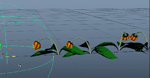

Depending on your animated objects you could also create "Animated Snapshots" and then use the create_instances node to play through these objects on a per point bases.
The offset per instance point could be a point property like particle age.
In this example I'm using a field (the wireframe sphere) to set a value for the points (flowers) and that chooses 1 out of 40 anim snapshots.

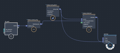

Based on @Roland.Reyer's answer up there, my solution would be this:  Make a for-each loop.  The max iterations should be set to the number of different, random offsets you wish to instance, so if you want 20 different animations, set it to 20.
Inside that for-each loop, add a time node, add a random number to it that changes (current_iteration into seed), then a modulo for looping (modulo returns the remainder of a division, so if you have 40 frames and a modulo set to 40, on frame 41 it will return 1, frame 42 returns 2, etc).  Plug the modulo into the frame input of your alembic read node and connect that to the output f the loop.
This will generate the number of instance geometries you want, with random animations.

If you don't want it to be random, convert the current_index to a float and add whatever delay you need to it then add that to the frame 🙂
