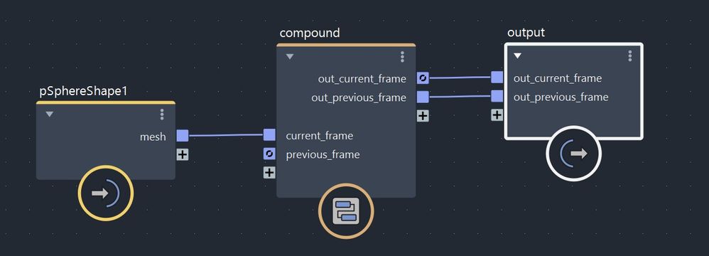

Here is the simplest way to gest previous frame data.

Im Very confused how do i get a compound node to do that?
sepu6

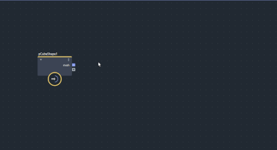

its just a solver (feedback loop), so you can use the simulation example node.
or you can create a compound, then you right click on the port and set the feedback port.
Like this
