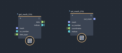

concatenaN6AA3
Thanks! What about UVs ?
sepu6
You can get the UVs and then set them after the operation.  You could also try to transfer them with `transfer_properties_by_indices`
concatenaN6AA3
Aja! I didn't know this nodes. I will Try it. Thank you very much.
