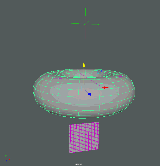

I'm able to query a geometry's closest uv at a given point, but how can I reverse that? If I have this float2 uv value then how can I convert it to a position? Was anybody able to do this?

You query the closest location on the UVs, but sample the location on the actual 3D geometry. Since your UVs and the 3D mesh have the same number of faces, and closest location works using barycentric coordinates, the sampled location will give you the closest position on the 3D mesh.
The tricky thing is that you to construct a mesh from your UV data to do the query, because the query has to be done on the closest location on a face. query will still happen in 3D even if you input float2 as positions.

And here's how to get the standard uv data from a mesh.

That looks really cool! So from what I understand you're building a mesh from the uvs to make that plane geometry, getting the closest location from it using the locator, then finally sampling the location's position but with the original sphere to get the red point's position?
I guess the thing I'm struggling with is even if I built that mesh from uvs I won't have that locator on my setup so I would have nothing to query from.
I kind of figured I would have to extract more info from my initial closest location when I get the uv value so I can use it later to map onto its updated 3d position. Which leads me to another question: how can you sample any other info from a location? For the life of me I can only pull position out of it, but from what I understand in this link there's way more properties that I should be able to pull. I'm not too sure what the names of the properties are and how to check though as the watchpoint is empty.
Yes, that's exactly what it is doing.
This is using a locator in this case, with it could be anything, like another mesh's point position... If you don't plug anything in the position port you won't query anything either.
You can query almost any property from a mesh, relying on either the point_component or the face_component. You just got to make sure the "default" type you are setting on the "sample_property" match the actual property you want to query. If you can't see the data on your watchpoint, you can use a "dump_object" node to write your object to a text file. there you can see every single property it is holding, along with its data.

Ok! Got it working!! Thanks for the help, Max! At first I wasn't completely understanding your first post and how that relates to getting the out position, but after replicating it and playing around I got it.
I'll share a test scene that does this so if anyone one else has the same issue they can check out the graphs where I left a few comments.
This scene does the following:
  1. Grabs the closest uv from the input locator
  2. Builds a new mesh from the geometry's uvs
  3. Takes earlier uv to convert it to an actual position that is connected to another locator
So this specific example is sort of redundant, but the point is that later on if the geometry deforms but I grabbed its uvs from the start I can still use them to get its deformed positions. Basically I'm thinking of trying to do a mini wrap deformer compound that's driven by uvs.
