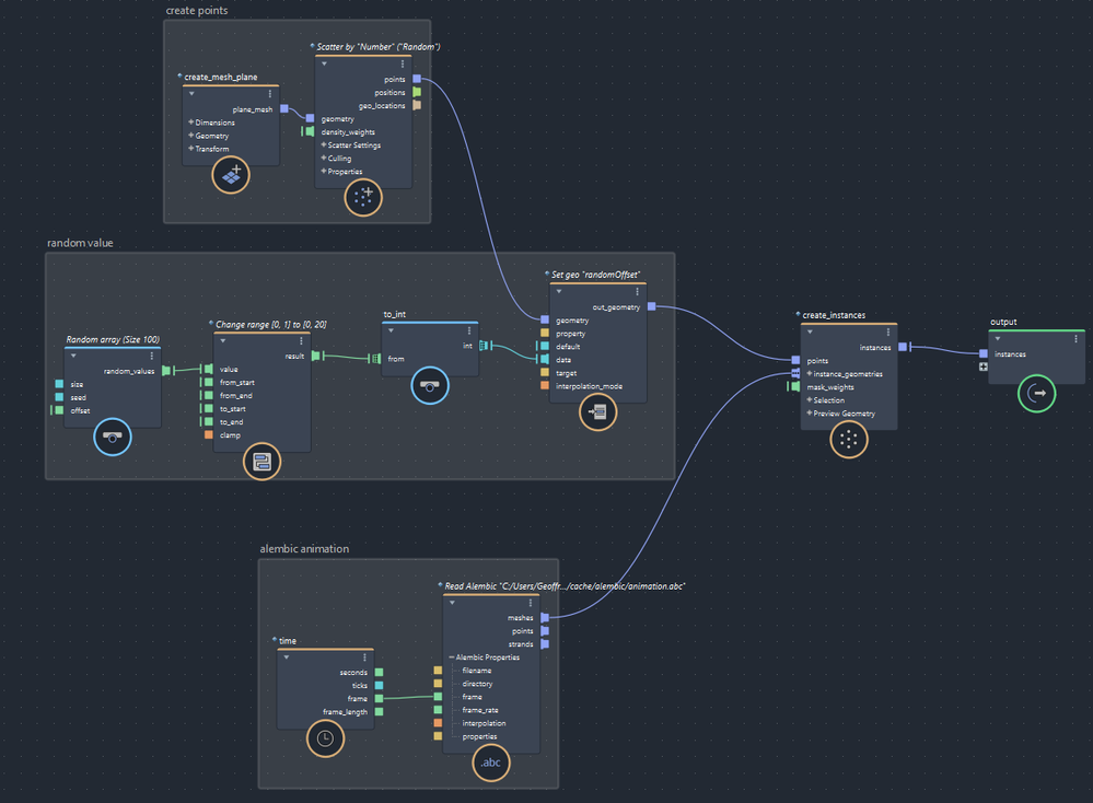

I have an animated alembic sequence file, which I import in Bifrost graph then scatter.
I want the alembic sequences to have random offset in the animation sequence.
I've generated a random value property for each points but I don't know how to use it to offset the animation now. Can I feed the value after the time node to add the offset?
Any helps appreciated 🙂
Screen of the graph attached + the bifrost scene

if you are in the BF discord check this out
https://discord.com/channels/872260298508222534/1172235893646557254
That's easiest

But I'm not using Arnold (Redshift here) so I'm using read_alembic node instead of Arnold_Alembic_Instance.
And there is no Frame property in the basic alembic node, unfortunatelly.

There is another way but is a little more cumbersome. I'll post an example a little later, also keep in mind that you gonna have to bake your instances since RS does not support it.
g_godet
Thanks, Yes but maybe exporting as USD would keep the instances to be used in Redshift.
