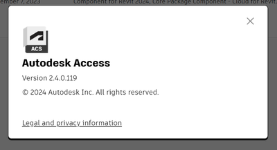

I recently installed the latest version of Autodesk Access v2.4.0.119 as shown in the Control Panel and was surprised to see the registry key under HKLM:Software\Autodesk\ODIS -Name ODISVersion has been removed. A new value Name Version has been created and another key Access has been created.
The latest ODIS version appears to be v1.44.0.502 but I can't find anything related to the versions of Autodesk Access. Did Autodesk Access just replace or better yet incorporate ODIS as both the modern installer and updater? I want to make sure all of my clients are running the latest version of Autodesk Access.
Latest install on my machine:
Co-workers Computer:
I noticed the version of this installation is the same version of ODIS. A release date would probably help understand what is going on here.
