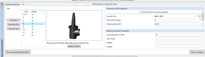

This would be a huge help for refrigeration design and HVAC companies.
Danfoss offers most of their catalog of 3D valves, But not as a Plant Catalog.
Danfoss CAD library

Did you ever get any further with this? Is it possible to use Danfoss models in Plant 3D?
nate_bronkema
Yes, I had to create the libraries myself, using the Danfoss valve models.  I got the ISO symbols to work too.  It took lots of experimenting to get it to all work.   Currently I only have the Hand valves working.
