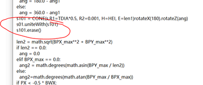

When using uniteWith method to union two objects in python script, the error was displayed in the command line.
"The Boolean operation on solid and/or surface bodies failed.
Modeling Operation Error:
Error Code number is 18026"
Did anyone else notice this situation?

居安思危_Hu
Plant 3D version 2024
It can work well if delete the marked codes. The below snip is what I need.
matt.worland
I see the same issue with your code in 2024 and 2025. I was able to get the cones to union and the base to union, but I could not get the base and the cones to union together. I would send to Autodesk Support to take a look.
