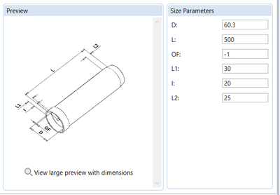

Hi. I've added a pipe with threaded ends (THDF/THDM) in the spec, and socket with threaded ends (THDF/THDM) too.
However when i route it in 3D project, there are only pipes with gap, no socket in between. Any steps missing here? I only use default setting for project.

I think the pipe you added in the spec was actually a Pipe Nipple I guess.
In Size Parameter modify I/L1/L2=0, Try using this I think this will help.

Set I, L1 & L2 to negative value.
