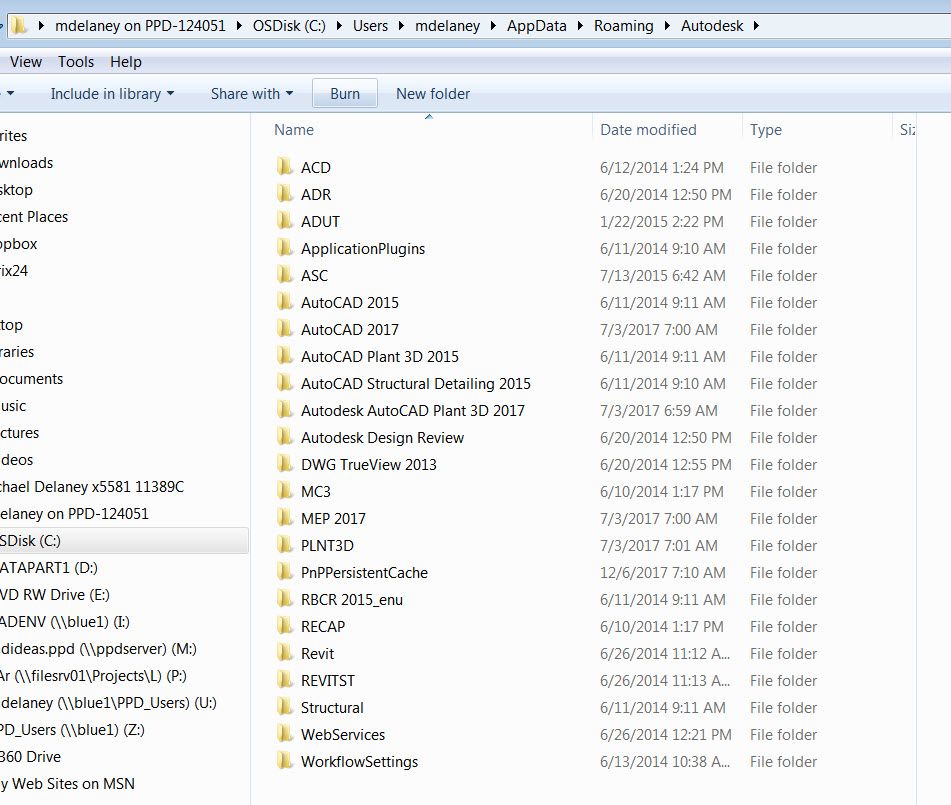

I tried this with a colleague and we were unsuccessful in finding the file structure for Plant 2017 that match these instructions. Someone earlier offered some additional instructions that I have yet to try, that will allow a reboot as well.  I have attached my file directory image. Maybe you can provide the path from this point. Thanks 1 Local Directory Path.jpg1 Local Directory Path.jpg

In your picture there is a folder called "Autodesk AutoCAD Plant 3D 2017". This is the first folder which you can delete/rename. This was for folder C:\Users\MDelaney\Appdata\Roaming\Autodesk\.
The second one is C:\Users\MDelaney\Appdata\Local\Autodesk\AutoCAD Plant 3D 2017
At the end you have to open registry via Start - Run - REGEDIT - Enter
Switch to the location, mentioned in the article and delete there the key
Note: The location of the registry key starts with HKEY_CURRENT_USER....!

Thank you got it!
