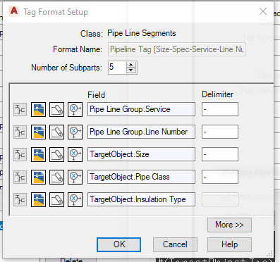

Trying to assign a tag to a branch line on a P&ID and get an error message stating "no two schematic line groups can have the same tag" Only problem is that this tag has not been assigned to the drawing or the project. Please see snip-its. Any direction is appreciated. Thank you.

can you show us a picture of your Line Group TAG format.
Not this from the line segment
If my reply was helpful, please give a "Kudo" or click the "Accept as Solution" button below (or both).

bquataert
As requested
works with other digits.
Message 8 of 17
bquataert
wont let me place line number 0006 either but will let me place 0007

Try running the "PnPLocalDataCachePurger" in addition to doing the Project Audit.
https://knowledge.autodesk.com/support/autocad-plant-3d/learn-explore/caas/screencast/Main/Details/6...
Also try removing this drawing from the project completely and create a new drawing.

Sounds like you need to remove the drawing.  Creating a new drawing, without removing the old one, will not work.

@bquataert
You could try doing that.  I've used that technique to fix corrupted drawings in the past.
But if it does not work you will need to purge it from the project.  Remove it, run the project audit, then run PnP purger.  Make sure no one else is in the project too.
To reduce redraw time, you could bring it in as an xref, from a separate project and trace it.  I wouldn't try to copy anything in, something happened to this drawing and you don't want to re-corrupt your new one.
