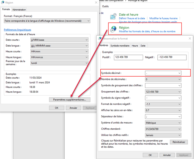

Hello
Click the Start button, and then click Control Panel. Click Change date, time, or number formats. The Region dialog box appears. On the Formats tab, select the format you want to change from the drop-down list.
== French ==
Cliquez sur le bouton Démarrer, puis cliquez sur Panneau de configuration. Cliquez sur Modifier les formats de date, d’heure ou de nombres. La boîte de dialogue Région apparaît. Sous l'onglet Formats, sélectionnez le format que vous souhaitez modifier dans la liste déroulante.

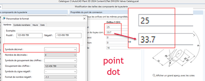

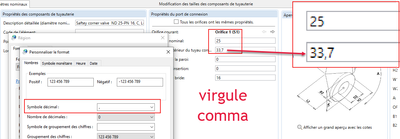

Hello
On my W10 computer, by changing the decimal separator "," to a separator "." in the Windows regional settings, the effect is taken into account in SpecEditor.
To see the effect of the change in SpecEditor you must open it again.

Sur mon poste W10, en changeant dans les paramètres régionnaux de windows le séparateur décimal "," en séparateur ".", l'effet est bien pris en compte dans SpecEditor.
Pour voir l'effet du changement sous SpecEditor il faut l'ouvrir de nouveau.

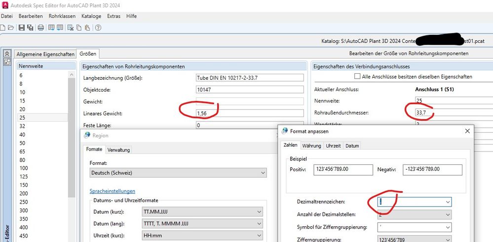

Yes, you describe the expected behavior. This is just not the case here, also after restart of the machine (see picture below).
Currently, the technical support is investigating. There may be a bug in the german version of plant 3d 24. We have to wait for a confirmation.

Dear @dominikhofer8850 ,
No, it is not a problem with Autodesk AutoCAD Plant 3D German! The problem lies with the administration of Microsoft Windows. We are not responsible for that here.

Thanks for your participation. In fact it's interesting your german version of Plant 3D 2024 seems to work fine. Considering following testing (on my side) and the feedback from technical support, it may be worth to find the cause.
In the meantime the technical support of Autodesk confirms a possible issue with all non-English Versions of Plant 3D 2024. For me, it's currently unclear what causes this failure, and may surely lay in the responsibility of Windows. Further testing here reveals, that also the German Version of Plant 3D 2023 fails to take over the windows setting regarding delimiter while all English Versions, especially the current Version 2024 are working as expected. So, working with the English Version is currently the workaround.

Hi again @dominikhofer8850
thx for your quick reply. Meanwhile I shwitched decimal character in the regional seetings of Windows to <point> as @h_eger said. Additionally I made the same change in Excel... Now there is no more false date instead of the nominal diameter (21.3 <> 21.03.2024 or 26.9 <>26.09.2024) after exporting from Spec Editor an opening in Excel.
You should give it a try, as I am also working with the German version of Plant 3D 2024.

Hi @schusterAPRO
Thx for your info. Again, you describe the expected behaviour when performing the actions, described by @h_eger. I'm happy it worked for you, it just didn't do the trick here. Maybe there was an update in the meantime, maybe it's just here, or on swiss systems, which are also different to german one's in regard of system localisation settings.... It's still unclear.
Surely i can give the german version a try one day, for now, we are happy with the english version ;-).

Hello Dominik,
now you have given the decisive hint that you are located in Switzerland and have a Windows system in Swiss German, which explains your behaviour.
Well, my customers in Zurich and St. Gallen had the same problems and we changed the operating system to German-German, so the problem was solved.
