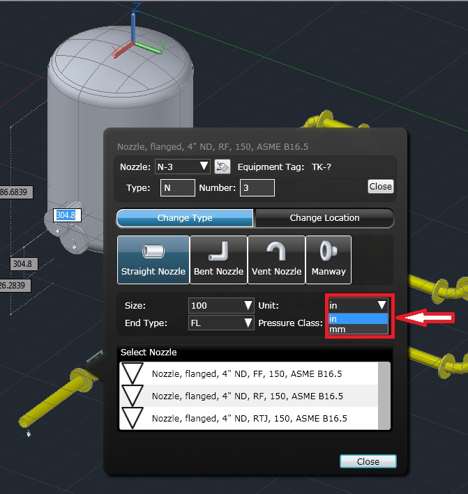

In a metric project I can’t choose an appropriate flange/nozzle for pump equipment created in Inventor or 'PLANTEQUIPMENTCONVERT'. The only available option is a DIN spec flange.
I can create a pump using 'PLANTEQUIPMENTCREATE' and get all the choices available to me.
Two hours later, still can’t figure it out. It has something to do with being a metric project  I think...
Creating an Imperial project I can add a ANSI spec flange to equipment but can't do it in a metric. How are the nozzles determined? They should be part of the spec.

The nozzles don't depend of spec. When you enter on add nozzle of equipment you need to select units (mm or in) depend of this unit the specification of nozzle will be ANSI or DIN.

Looks like I needed my wife to find it as it was right in front of my face!
Thanks for the really obvious red arrow!

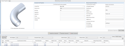

Nachricht 14 von 16
Nole.DelaCalzada
Like this
0 „Gefällt mir“-Angaben
Nachricht 15 von 16
Tomislav.Golubovic
The sizes in the listing need to be in mm, that's why its not showing in the nozzle dialog in P3D
