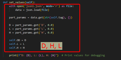

Hello everybody,
I'm having trouble connecting a JSON file to Python. I'm currently making a custom valve with numerous parameters. I created a JSON file and added parameters to it to reduce the number of parameters. But it's not working. You can see code from JSON and python.
Someone can help me fix that.
Thank  you!
    "1": { "D": 8.625, "L": 15.0, "H": 8.625 },
    "2": { "D": 10.625, "L": 25.0, "H": 10.625 },
    "3": { "D": 12.0, "L": 36.0, "H": 12.0 }

    def set_values(self):
        with open('json1.json', mode='r') as file:
            data = json.load(file)
        part_params = data.get(str(self.tag), {})
        D = part_params.get('D', 0.0)
        L = part_params.get('L', 0.0)
        H = part_params.get('H', 0.0)
        self.OD = D
        self.L = L
        self.H = H
        print(f"D: {D}, L: {L}, H: {H}")  # Print values for debugging

matt.worland
You were pretty close with reading the data. Using the below method works for me.
    try:
        with open(r"C:\AutoCAD Plant 3D 2024 Content\CPak Common\CustomScripts\test_valve.json", mode='r') as file:
        part_params = data[str(self.tag)]
        self.OD = D
        self.L = L
        self.H = H
    except Exception as e:
        print(f"Set Valve Error: {e}")
        raise

traiduong014969
Thank for your reply.
Yes, I just tested it, and it works. So I have an issue:
Your solution works when the path is right with the AutoCad version. However, with the AutoCad version lower, This file will not work. So there's another way it's compatible with most versions?
matt.worland
You should be able to put that file anywhere you would like, as long as Python in P3D has access to its location in here sys.path
If my reply was helpful, please give a "Thumbs Up" or "Accept as Solution"
traiduong014969
Thank you matt.worland for help. It's working for me
