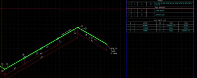

Message 5 of 11
mauro_spadaro
Hi, for the standard Pipe SUpport you get positioning, list and dimensioning on the iso but for the custom one you get nothing even if set to New .
See image.
Any ideas?
thanks

darrelldixon
Could you possibly post a copy of your model with that straight pipe and both supports?
Message 9 of 11
mauro_spadaro
attacjed yuo get the 3d file.
thanks
bye
mauro

Dadspackard
@mauro_spadaro,
I tested the drawing you attached and got the same results it did not dimensions your custom support.
I copied your support exploded a few time and made a new support. Same results.
What I discovered is you need to fill out the Descriptions for the support for it to dimension and show on the BOM
Let us no if this resolved your issue
Have a great day
Tom
