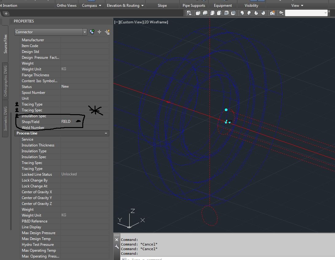

I have a slight irritation in that when adding a pipe run into the back of the blind flange, although it models well & there are no issues, but when I run the iso the tap weld doesn't show up on the iso. The only time it does appear iso is when you change the weld from a shop to field weld, then it does appear on the iso. When a SOL or WOL is added to the flange instead of the pipe then weld does appear on the iso correctly - so is the pipe connection weld a bug or can anyone advise a solution.

Dear @MOLGRAND,
unfortunately I can not repruduce your mistake.

Thanks for coming back to me.
I am running P3D - 2018, what version did you generate the Iso on? I have reloaded 2018 again today from scratch to make sure I didn't have any software issues & I just created a new project metric-metric so its an out of the box set-up with no changes & used the final Iso template & I still get the same error result!

Dear @MOLGRAND,
also in 2018 the action is successful

Dear Molgrand,
the reason therefore is in most cases configuration. Please, can you send us the following files:
  1. Small sample model drawing
  2. Zipped iso style folder
  3. From <project folder>\Isometric the following files:
    1. IsoSymbolStyles.dwg
    2. IsoSkeyAcadBlockMap.xml
  4. DefaultConnectorsConfig.xml from project folder
