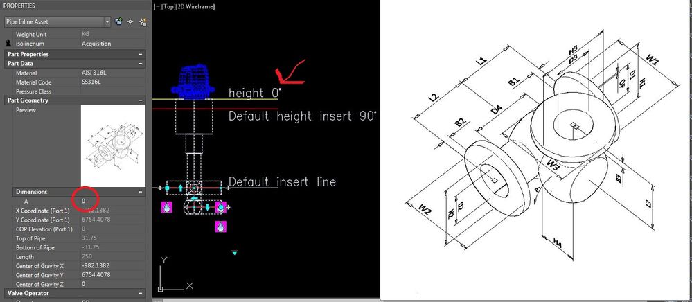

I have the following problem, I am using the Tuchenhagen multiport valve catalog but I need to change the actuators to make them look more realistic. I have generated the actuator block and I have generated the PLANTPARTCONVERT.
I assigned the actuator to the valve and everything works perfect
The problem is that when I modify the angle in the lower housing, the insertion point is modified in the Y axis
Otherwise, the insertion point moves on the X axis
does anybody know how I can fix it?
I would need that in all cases the insertion point be the same
Thank you

I have same problem, but if you write 0.000001 it is ok

@Matias.Martin79  please put the angle as per below:
Angle  = current angle value  + 0.0000000001
for exmalpe 90
Angle= 90+0.0000000001=90.0000000001
then actuator will not move.

The actuator for multiportvalve need to lay down flat and point in +Y when you create the block for it.
Following this guide may help you. We hade the same issue until we found out how multiport valves are treated by the system.
