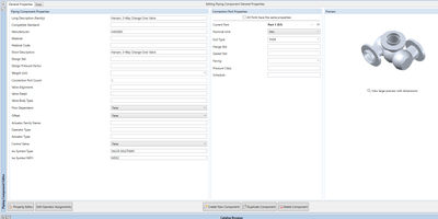

Hi All,
I am needing some advice on this type of valve below for Isometrics generation.
So far, the only way I have managed to get this remotely close to being acceptable is to set it up as a multiway valve.
However, the isos are turning out as below image A, the bottom port is also facing up where it should be down.
It would be much appreciated if someone would know how to get the port facing down in the correct direction.
Image A- Not OK
Image B - Preferred
Basic 3D model of the valve Block connected to the pipe below
Port creation sequence when using PLANPARTCONVERT
Catalogue Details:
IsoSkeyAcadBlockMap.xml Details:
I duplicated the existing MPV and renamed some items so I could get the ports to look like threaded / socket ends.
MPVBody1 Block
I created this so the ends appeared threaded/socketed on the isos
MPVSpindle1 Block
I added a 3rd port point to see if it would make a difference, I tested without the 3rd port and had similar results.
Cheers

joakim_lindh
Hello everyone. I had a go at this today to help a customer get sorted. This is what I did to make it work.
  1. Create a block-based Plant 3D part.
  2. Make sure the block is laying flat with the actuator facing +Y (EXTREMELY IMPORTANT).
  3. Also, make sure to have the basepoint of your block somewhere inside the block between Port 1 and Port 2.
  4. PLANTPARTCONVERT the block and place the first port at the TOP closest to the actuator. When adding the actuator to the component in Spec Editor, this is where the block will be placed later.
  5. Create a DUMMY actuator so small that it does not show up outside your block. In my demo here, it's larger just to show you that it's inside the valve.
  6. EXTREMELY important that the Actuator is placed at the 0,0,0 position and that the top of the actuator is facing +Y.
  7. PLANTPARTCONVERT the actuator but don’t add any ports to it.
  8. Create the object in SPECeditor. Make sure to select Valve Body when you create the valve; otherwise, you can't assign an actuator to it.
  9. SKEY = MD??, TYPE = VALVE-MULTIWAY.
  10. Add the actuator to the component in Spec Editor.
  11. Add the valve to a spec.
  12. Restart Plant 3D to make sure the block is recognized by the system if you get the warning 'Can’t find symbol for specified part.'
One last thing, Dont forget to add the actuator in the "IsoSkeyAcadBlockMap.xml"
<SkeyMapMPV SKEY="MD??" AcadBlockBody="MPVBody" AcadBlockSpindle="MPVSpindle" AcadBlockActuator ="MPVActuator"/>
