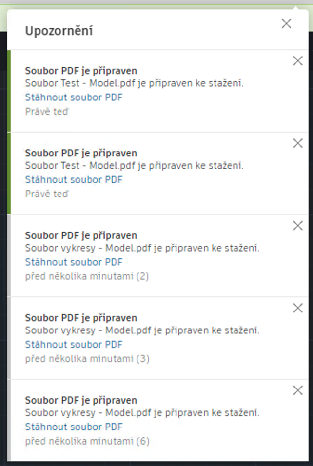

After I choose plot to PDF everything seems to be OK. But after clicking to link Save PDF file, app just opens another tab with drawings. I've tried three browsers in two operation systems. Nothing helps. A month ago the same drawing worked fine.
Thanks for help.
