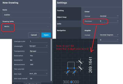

hi
starting a new drawing, with metric and decimal precision = "0", i always get 3 digit precision on the DIM command.
how can i overcome this?

A flaw you cannot control at this time: you'll have to wait for Autodesk to fix it.

Thank you for your heads up. You are referring to the topic above. Does this mean, that you are in the same situation or do you have different conditions?
If this is the case, I just tested the following basic steps on my side:
  1. Create a drawing in AutoCAD Desktop.
  2. Enter DIMSTYLE in the AutoCAD command line.
  3. Edit a dimension style or create a new dimension style with your requirements. On my side I tested with precision = 0.
  4. Save the drawing via SAVETOWEBMOBILE.
  5. The drawing can be opened in the AutoCAD Web App.
  6. Enter DIM to create a new dimension.
  7. Open the properties of the created dimension.
  8. Choose the Dim style that you created and that fits to your conditions.

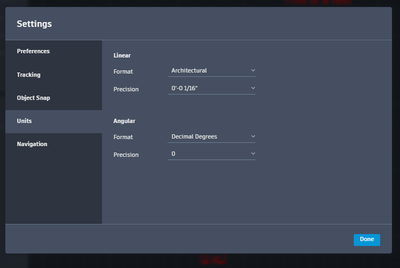

Since these posts go back 2 years should we assume that Autodesk isn't planning to fix? I can't figure out how set units (feet, inches, etc). Also, if I use the "standard" dimension style the text is too small. I can adjust the size by using any of the "Decimal" styles but they display a comma where the decimal should be. What is causing that?
Your file still needs to be preset for that. in SETTINGS you can only change these
Your file still needs to be preset for that: text STYLEs and DIMSTYLE settings (and options/alternate choices etc.) and more.
Your file still needs to be preset for these many items.
FWIW AutoCADWEB and AutoCADMOBILE are not desktop replacements yet, they remain "adjacent seat" tools, mostly designed to be used for minimal markup/editing and "review". Heavy lifting is still expected to happen on a desktop I believe.

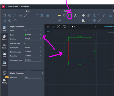

With that said, their are shortcomings with working with AutoCAD for the Web. By far the biggest annoyance is that even though precision has been set (to 1 decimal place for example) in the Settings->Units->Precision field, dimensions that are created show 4 places, which causes lots of problems with placing dimensions obviously. The only solution I have for my students is to have them use the Properties->Text Overide field to re-write their dimensions. This is a huge hassle.

I see some of these posts are quite old.  I just bought this today, if I cant dimension my drawing properly, it is useless.   Does anyone have a fix for this?

How did you get your dimensions to dimension to two decimal places without overriding the text?
Message 18 of 27
pendean
Community Legend
Community Legend
That file was started in desktop AutoCAD with full controls over settings, something the web app totally lacks at the moment.
