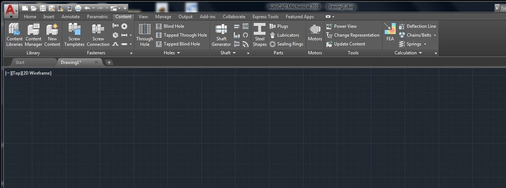

Hello
I often use the beam calculator functions in Mechanical
But now this complete menu seams to be missing.
Have I somehow removed it and if so how do I get it back?

Hi @Mustang69,
Thank you for the screen shot. It looks like you are running AutoCAD Mechanical as Vanilla AutoCAD.
If you open OPTIONS, go to the Profiles Tab, select <<ACADMPP>> and press Set Current then OK, does this look correct?
Also, if you have not done so already, 2018 has 2 updates to be installed, one for Mechanical, and one for core AutoCAD.
How To: Installing AutoCAD Mechanical Updates
Please let me know if this resolves the issue.

Mustang69
Hello
Thanks for the answers.
I installed the most recent update and also checked the profile and it is in ACADMPP
Nothing seams to help here
I also checked the workspaces.
Are there something missing?

Hi @Mustang69,
It looks like there is a newer update for core AutoCAD (the current build update is 2018.1.2). Maybe see if that resolves the issue. After that, I would say it looks like a corrupted install.
The next step I would suggest is to Reset to Defaults - How to reset AutoCAD to defaults or Reinstall from the operating system - How to repair or reinstall AutoCAD installation.
I always suggest test running the program prior to reimporting any settings in case the issue is with a damaged profile. You can save a copy of the existing profile from the Reset to Defaults option or as described in here:
How to import, export, back up, and transfer settings to and from AutoCAD

Mustang69
Hello
I could not solve this problem.
Finally I removed 2018 and installed the new 2019.
Look great and all tools are there!
