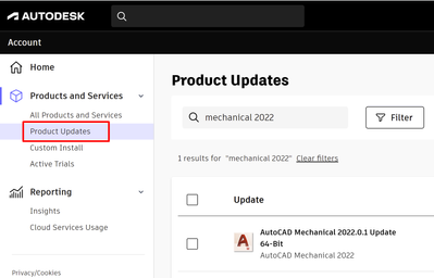

For AutoCAD-based Toolsets (Vertical products) (Mechanical for example) there will be 2 updates to check and install,
  1. One for the Toolset.
  2. One for core AutoCAD.
You can easily check which updates have been installed using the ABOUT command.
Updates are available for downloaded and installed from your Autodesk Account or at manage.autodesk.com under  Product Updates.
 There is also search box to narrow the search results. If you do not see results for previous versions, click the Release date drop down on the right and select a larger range.
