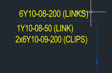

Community Visitor
Hi there, I'm looking for some help to get the illustration of my text the way I want. I want one text on the top and tow text lines to be on the bottom like illustrated in the picture
Message 9 of 11
wolfgangorlinski
Hi People,
Does anyone know how to make multiple lines? See the attached png.
I tried using e.g. GIB TO \X COLUMN GIB \X TBC however it only seems to allow one \X
anyone done this?
Cheers,
Wolf
Message 10 of 11
martynLAWNG
The \X function only allows you to put part of the text below the dim line.
If you want to put the TBC part on another line, treat it as you would an MTEXT box. Either use the return key or contract the text box with the slider.
Message 11 of 11
wolfgangorlinski
Thanks very much for your help Martyn, thats answered my question!
