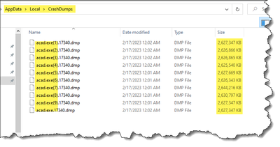

I was running into this as well and luckily found a possible reason.
In the AppData/Local folder there is a folder called "CrashDumps" and lo-and-behold I found 25 gigs of AutoCrash stuff.
I cleaned these out and it freed up a lot of space for me. Hopefully, this will help someone else too.
