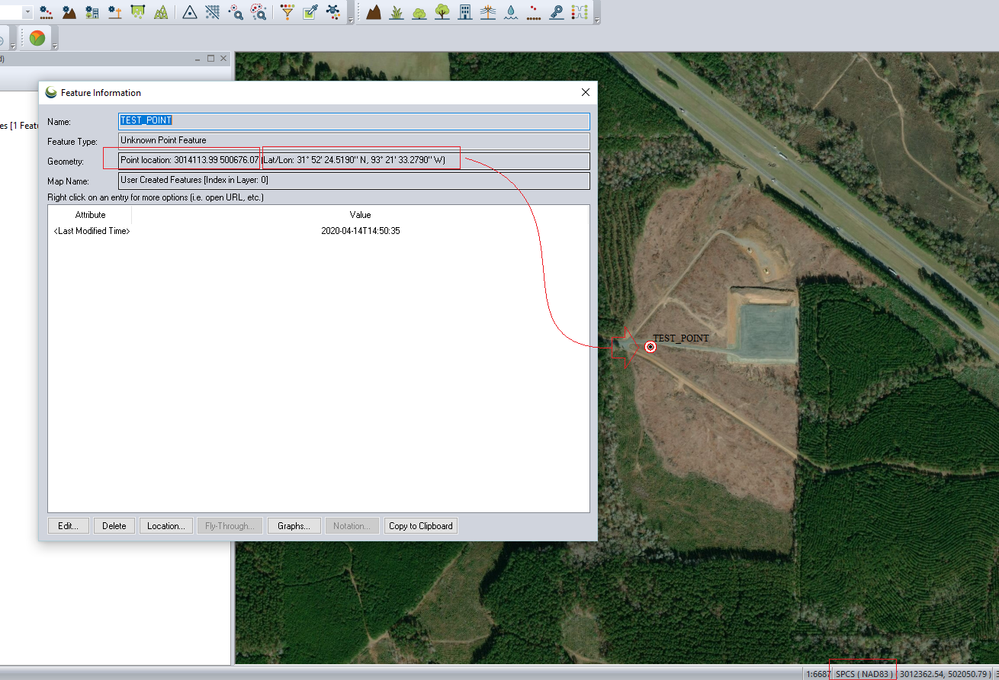

This issue has been misdiagnosed as an error with either NGS NCAT or as an error with Civil3D. However, when using geographic coordinates, not projected coordinates, to test a point location, Civil3D is consistent with the coordinate transformations. The only error I can see, is the way NGS NCAT is transforming the Lat/Longs. This indicates there could be an error (or poor decimal precision) in the 'input' you are giving NCAT and not an error in the 'output' of NCAT's coordinates.
Image-1. For best results, provide coordinates to NCAT, using coordinates with 6 decimals or more.Image-1. For best results, provide coordinates to NCAT, using coordinates with 6 decimals or more.
Image-2.Global Mapper. The projection being used in LA83-NF.Image-2.Global Mapper. The projection being used in LA83-NF.
Image-3. Civil3D. Compare coordinates to image-1.Image-3. Civil3D. Compare coordinates to image-1.

Whether NGS is the leader in your area is debateable. The interface of the NGS is woefully inadequate because the 'projected coordinates' (x,y) can accomodate only 3 decimal places whereas 'geographic coordinates' (Lat/Longs) will accept 10 in decimal format and 5 decimals in DMS format. The precision in your input makes a difference and with only 3 decimals in your x,y values, the leader in your area is daring you to use geographic coordinates instead of projected. Time to find a new online converter?
The error you are getting is due to your incorrect input. You are using NAD83(2011) epoch. You should use the NAD83(1986) epoch instead. And if you wish to maximize your output, combine the 1986 input with lat/longs instead of x,y feet.
For input use NAD83(1986).For input use NAD83(1986).
If you wish to get NAD83 State Plane or NAD83 UTMs, both the input and output datums must be NAD83(1986).
