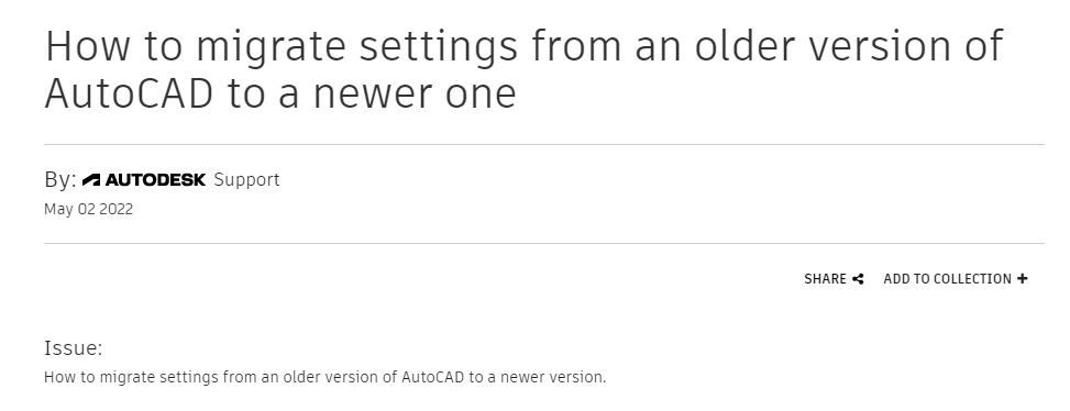

You can read this Support Article (dated 5/2/2022) addressing your issue.
Note: the article mentions certain conditions that must be present for the workflow to succeed so the solution provided may not apply to your specific situation. Good luck.
