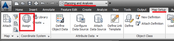

Message 4 of 26
АлексЮстасу
Assign a coordinate system in the drawing: _MAPCSASSIGN
-- Alexander, private person, pacifist, english only with translator 🙂 --

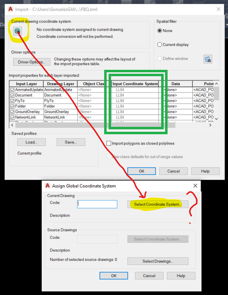

Andres-Felipe_Gonzalez-Gil
I'm trying to import a .kml into AutoCAD Map 3D 2022 but there is one problem. I have the klm file with all the information and I want to import it to autocad to edit the information. The only problem comes when I have to choose a Coordinate system. I dont know wich system Google earth export it.
what should I do to select in autocad the coordinate system, which from Google Earth pro as klm has been exported?
Message 19 of 26
Data in Google Earth in WGS84.
In Map 3D, the corresponding code is LL84.
But you can choose another coordinate system, whichever you prefer.
For example, metric, foot. Or so on. MAPIMPORT will convert from WGS84 to the assigned coordinate system

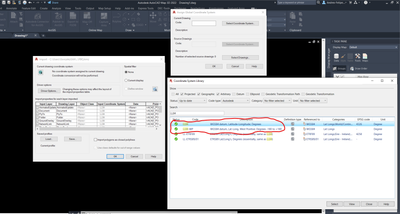

Message 20 of 26
are you saying I shouldnt select in Autocad Maps 3D the coordinate system? because I searched the one you meaned (LL84) and also I got more than a coordinate. Do you know where do I find more information about coordinate system between Google Earth pro and Autocad Maps 3D?
