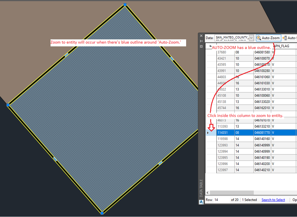

There's a subtle, very subtle, relationship between the Auto-Zoom button and the individual rows in the table. A Blue Outline surrounding the Auto-Zoom button is either toggled ON or toggled OFF (see image-1).
1-Auto-Zoom button does not have a blue outline.1-Auto-Zoom button does not have a blue outline.
While in your table view, you can click directly on top of the 'Auto-Zoom' button. When you do, a Blue Outline surrounding the button will appear. Click it again and the outline toggles OFF. When the outline is ON, you will zoom-in on the entity provided you click inside the extreme left column (see image-2). When you are zoomed out, and the outline is toogled OFF, you will highlight the entity without zooming in.
2-Auto-Zoom button displays a blue outline so the zoom-in feature is ON.2-Auto-Zoom button displays a blue outline so the zoom-in feature is ON.

Peter2_1
@ChicagoLooper
thanks, that's a very precise description of this feature.
But I think that is exactly what I've done, and at the moment I don't see how it explains the different zoom factor I showed in my images.
