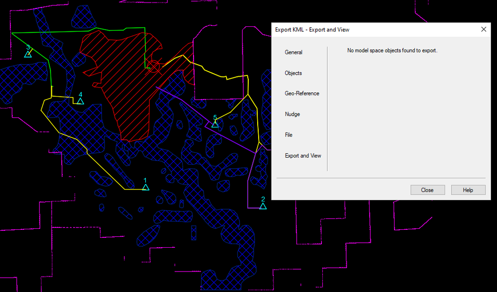

jmihalco
I have tried the same process on civil 3D and have GE pro. whenever I try to select the hatch for a kml export it gives me a "No Model Space Objects Found to Export" error. I am only able to export polylines, points and polylines. Any suggestions?

ChicagoLooper
@jmihalco
While in Modelpace, select the hatch. With the hatch still selected, take a screen shot of the Properties Palette so the hatch properties can be seen. Take a second screen shot, but this time select the hatch boundary. Make sure the second screen shot capture the Properties Palette so the boundary props can be seen.
Also, does the export procedure create an outline without hatch when exporting? Or does the export completely fail without creating anything?

jmihalco
I have attached two screen shots with the hatch selected and the boundary selected, both showing the properties palette. When The KML is produced, it grabs everything but the hatch lines, and the boundaries lines used to create the hatch. hatch properties.JPGhatch boundary.JPGgepro.JPG
