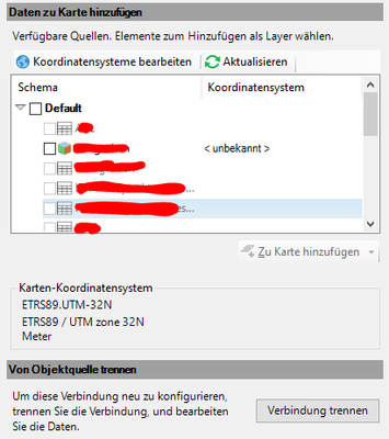

Would it be possible to upload a screenshot of the folder containing your shapefiles. It should look something like this:

Basically it looks like in your folder. But I am missing the XML and SBN files.
The both layers at the bottom are the SHX and SHP files.

I tried this method now. I drag and dropped my 20 .layer-files in the new project. Everything was shown for a few seconds. Now there are the same problems as before.
When i move the cursor over the layers in the data panel the message "object lass not available" appears.

And your image in post #15 indicates either
  1. your shapefile doesn’t have a prj file OR
  2. the prj is not being understood by Map3D. (You need to manually input the prj (projection file).
