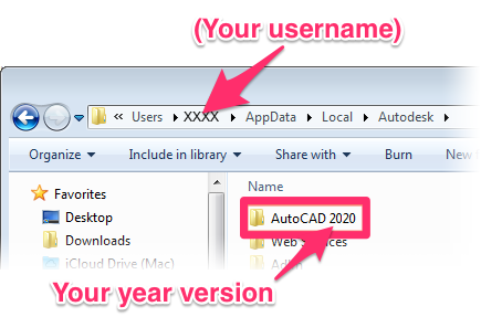

Cause
Your AutoCAD profile has likely become corrupt, resulting in this error message. To address this issue, you'll need to reinitiate the secondary AutoCAD installer, which will reset your CAD installation to its default settings.
Solution
1. Close CAD.
2. If you have created and saved an AutoCAD profile, export your profile as a backup from the CAD Options dialog box, Profiles tab. (You can open the Options dialog box by typing Op in the Command line.)
3. Follow our instructions to view hidden files and folders.
This step is crucial. Without your hidden files and folders turned on, you won't be able to see the folder paths referenced below.
4. Open your C: drive, and delete the following folders:
The examples pictured below show the folders you would need to delete if you have AutoCAD or F/X CAD 2015.
5. Open the Registry Editor:
  • Press CTRL+R (Windows keyboard), or Command+R (Mac keyboard).
6. Expand the registry keys (folders) to the path shown below, and delete the following registry key:
Note: The screenshot below shows an example registry key. The exact path of this key on your computer will vary depending on your CAD installation.
7. Restart CAD.
8. (if necessary) You may need to import your AutoCAD profile using the Import button in the CAD Options dialog box, Profiles tab.
