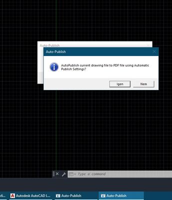

Hello!
I have a problem with my AutiCAD LT. While i work, the Auto-Publish windows randomly times pop-up. It's opening in a separate windows. Any idea for the solution?

Thank you the answare!!! Here is the problem:
This windows pop-up into my face while i working, and yes, it's opening in a separeted window, because it's run as an other taks in windows. The autopublish settings is on, i use this feature with "promt on close" options. I have been using AutoCAD for 5 years, this is the first time I have had such a problem.

Yesterday I tested, and i find out, the pop up coming out most often when i open a DWG file, or open block editor in the DWG file. Fun-fact: the pop-ups close automatically a few minutes later.

Q1: It can pop up at any moment, doesn't matter, what i like to do 😄 When i click 'yes', it does nothing, just like i click no.

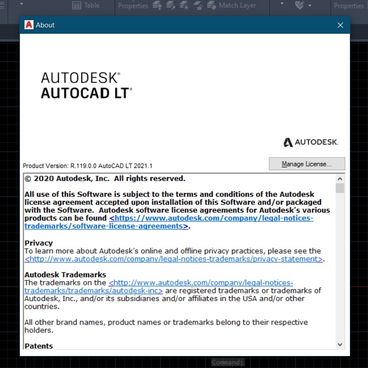

cadffm
"What exactly do you mean?"
Generally
A B O U T is a command, start this command and you can see the ProductNAME(s) and ProductVERSION(s).
For AutoCAD &LT you have one Productname/version, for Toolset you will find multiple.
The best way to share is a screenshot.
In this case, please post productname,version, AND
Command: _vernum
Feedback (_Vernum is often the Productnumber, but depending of installed Hotfixes, not)

Command: _Vernum
_VERNUM = "R.119.0.0 (UNICODE)" (read only)
My steps: I close my files. Open to try it with a new and totaly empty file, pop ups coming, so it's a same problem. I was created a block, the popup coming, open block editor, same result...
After that, i closed autocad, but the pop ups didnt closed! They live independent life 😂
So, i opened AutoCAD LT again, create a new file, create blocks, editing blocks, and it's work fine.
Conclusion: i think, the problems is in my DWG/DXF files, and they do something wrong, with my autocad (because after i close my files, and open new ones, the issue stay until i restart the software). What should i do?
