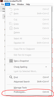

nick.brazier
Thanks for your help but I cant see PREFERENCES under EDIT in Acrobat ????
Message 71 of 79
h_s_walker
@nick.brazier See the image below or hold down CTRL+K
