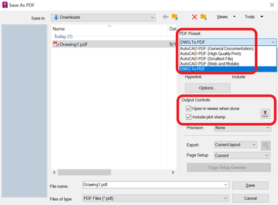

@MarcoEN8GQ ,
Consider using the PUBLISH command instead.
Note: Printer driver corruption can cause items not to plot. Update or reinstall the printer driver.
or Try the other PDF Preset.
Otherwise you may need to open a support ticket:
Or Resetting AutoCAD to Default:
