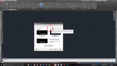

We are having an issue with the offset command within AutoCAD LT 2017.
When we specify the distance, say 25mm, the actual distance is entirely random, and different each time. this has only started since the most recent update.
We can draw and create other items as intended, however it is only the offset tool that has this issue.

Sorry for the late reply
The issue is now resolved, ironically, it was merely a setting that has become unchecked, rechecking resolved the issue.
Not sure who had changed the letting, however.
Thank you for the assistance, it is much appreciated

When you put dsettings as command, go to dynamic settings and make sure 'Enable pointer output' is also ticked apart from the one on the right as already mentioned above. This solved the problem for me.
