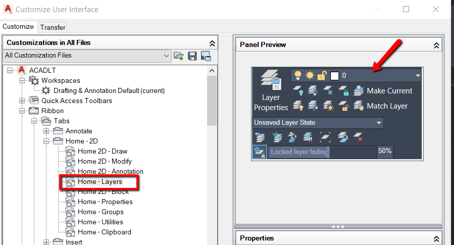

Hi @wrich44,
If this is the drop down you are looking for, it is a combination command tool and is not included in the tool list in the CUI.  It can be copied from it's original location on the Home tab, then paste it into your ribbon panel, though.
In the CUI Customizations in All Files pane, select Ribbon > Tabs > Home 2D > Home Layers. In the Panel Preview pane, select the Layer control you want.
The CUI will shift to the Panel location for the tool, which can be copied then pasted into your custom ribbon panel.
Please let me know if that helps.

Hi @wrich44,
If you are not seeing the standard ribbon panel in my screen shot under Home - Layers, it may have been deleted. The combo tool will not show up in the Command list and must be copied from the tree in the Customizations in All Files section as shown in the third image.
To reset to defaults, see How to reset AutoCAD to defaults.
I hope this helps.
