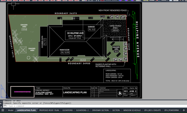

When I open your dwg I get this message:
Looking at the XREF palette I see 3 jpg files not found:
Then your current layout looks like this:
Are you not seeing these objects?
Perhaps it's a graphics card compatibility issue.

No, so I always click on ignore unresolved references.  They are to an old logo and they have never impacted me opening the drawing before.
My current layout does not look as you have shown.  My current layout is a black screen (see first attachment).
Then when I use the mouse to select a random area on the black screen the drawing appears (see second attachment).
It's almost like the layers are turned off.... but they aren't!
It's the same in the paper space.  When I hover the mouse over each of the tabs - I can see the drawing in the preview but then when I click
on the tab, the drawing disappears.

I did try the Gfxdx12 = 0
Another perspective.  I only downloaded Autocad Lt a few days ago.
A friend who has AutoCad Lt 2016 opened the file.  They had no problems seeing the drawing.  I asked them to save the drawing and send it back to me however when I opened it.... nothing.
This tells me it is a setting within my program given that everyone else can see the drawing bar me.....
