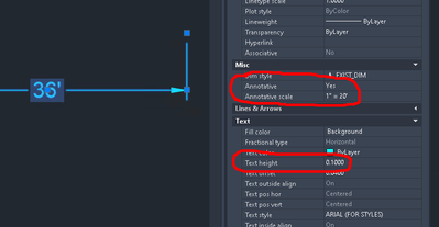

In short, when using Annotative text, you specify the text height in plotted units (i.e. 1/4", or 0.12", or 3mm, etc.) and not by the real world units size as we did for years before annotative objects.
If you select your dimension and look in PROPS what do you see for text height and Annotative scale? Note in my example below, the Annotative scale is 1"=20' and my text height is 0.1. The real world units measurement of the text is 2 units (20 * 0.1).
