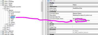

BTW, to turn off QUICK MEASURING so you never see it, start the MEASUREGEOM command, go into the MODE sub-option, answer NO to the question
This is what is behind those buttons in the RIBBON if you want to know more, the circled is the only thing that repeats with the tap of the spacebar or <enter>:
