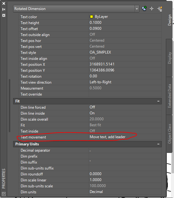

I've FINALLY found a solution. In the properties of the selected dimension scroll down to the "Fit" section. For "Text Movement" change the value to "Move text, add leader". Dimension.PNG

To "flip" or move the dimension text to the "other" side of the dimension line, you can use the Grip menu option, Move with Leader. Select the dimension and then hover over the text grip to cause the menu to appear.
After selecting the Move with Leader option, you can move the text independently of the dimension line. You must keep the text close to the dimension line if you want to keep the right-angle leader. Move too far and it becomes a leader connected to the middle of the dimension text.
Optionally, click the dimension text grip and then press CTRL to cycle through the text position options.
