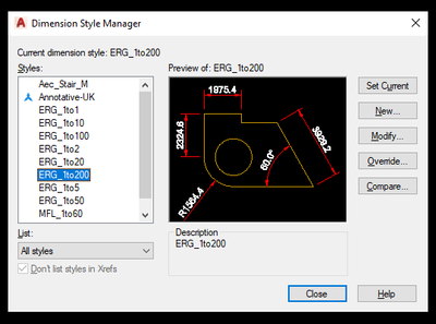

I am creating new dimension styles for my office. I have created them but whenever i dimension something it shows the layer that has already been deleted. Please see the snippet below. The first snippet is my new dimension style ERG_1to200. Whenever i select my layer ERG_Dims_Detail and dimension something. It is drawn in different layer automatically. Please help.
