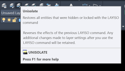

@Anonymous, I've discovered that if you use the ACA ribbon, the unisolate icon is mapped with the wrong command. So they've mapped the Isolate one correctly with the LAYISO command:
And then the Unisolate one with UNISOLATE instead of the correct LAYUNISO:
I've manually changed it in the CUI, and now it works.
Hope that helps

He wrote about another, an offtopic issue in an offtopic software
and you are using an Architecture version with this bug ?
(the Icon starts another command, so you oress&release the button, pressed [F2] and the started command is not "_LAYUNISO")
If so, the command to edit your .cuix files is: CUI
Ribbon, Panels, LAYER - ACA, row1
