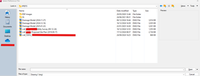

Matt_Shanly
The file path we use for xrefs is within project folders as the attached.
 When searching for xrefs this shows
This is the select reference window which shows the file location of the last xref loaded (any xref, not project specific) .  Meaning we have to go back through the file path to the project were now working in.
